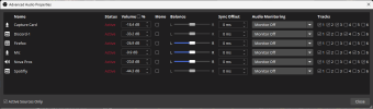

hi all
just need some help on getting media on a different track than my audio on my headset im just wondering how to do so because if i have the track muted you can still hear it on stream not sure what to do next
